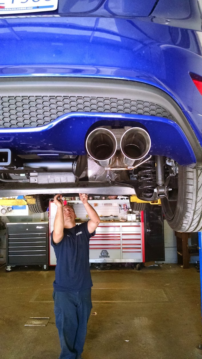

Here's what the tips look like in the bumper cutout from ground level:

How the tips extend out the perfect amount and follow the profile of the bumper:

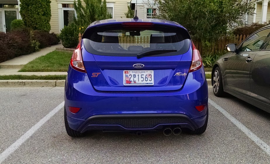

Finished product from the rear:
