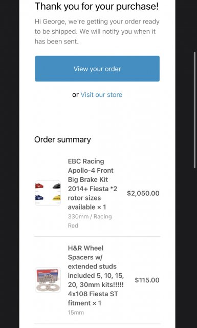

The EBC kit only requires 15MM spacers. I inquired about this yesterday.
