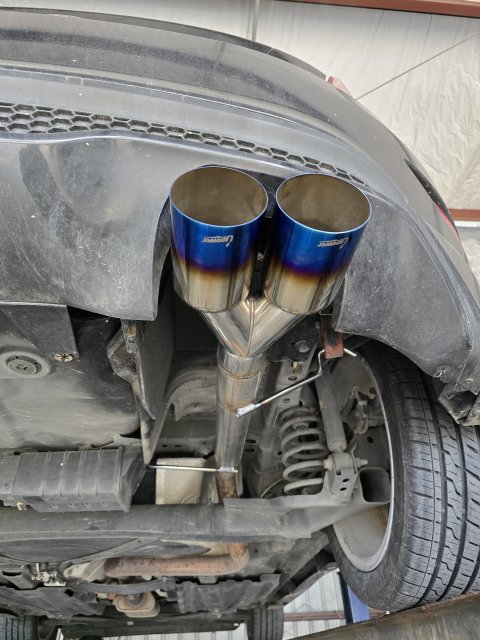

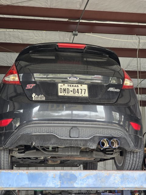

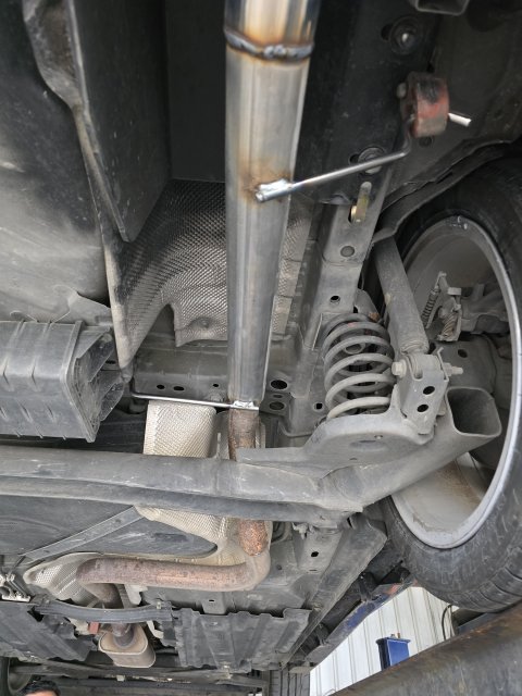

I've been running my car stock exhaust just cut it before the bends going over the axle. With the pre axle dump the car was very quiet on the freeway and no drone at all while accelerating under 2500 even tho muffler is missing. I found it quite nice it was LOUD when stepped on and quiet when saving gas. I also heard all the cool pop bang shift noises and the car was super deep sounding all from the drivers seat.
Today I finally had time to go get it routed out the back with my new tips and I'm hating the sound. It drones so much under normal acceleration under 2500 rpm. On the freeway it hurts my ears. All the cool noises are only heard on the exterior now. I would've never imagined this to be the case but I guess it makes sense since I added more bends and it resonates the back of the car now?
Do I go back to axle dump or should I try a side exit? Maybe someone can help me here. Thanks

My issue with resonators is they'll quiet my exhaust down as well. I'm figuring I'll probably just put a turn down before the axle again. Then I'll have to figure out how to block off the hole in the bumper cuz it bugs me. Does the piping have anything to do with this? The shop used aluminized pipe

I guess there was something wrong with my ears. Took it for another drive and now it's just what you'd expect... Quieter than the axle dump. I did notice the range of pedal where it's quiet is different than with the axle dump. Maybe it's cuz I did a second drive now? Idk either way case dismissed lol
Edit: Well it got quieter I guess cuz my driving adjusted to the sound but it still drones like hell and hurts my head on the freeway. I'll be going back to axle dump as that never had any issue

Drone relates to length of pipe and how it resonates with the frequencies the engine puts out.
This. And it’s not just that the frequency of sound produced changes, The RPM where the exhaust resonates and the noise spikes higher also changes. Shorter pipe, higher frequency which means the “drone” shifts up above ~3000 RPM. But cars use long exhaust pipes to make the exhaust exit behind the car, to fit resonators and mufflers under the car and the total length also cools the exhaust coming out and also helps reduce noise levels.
That makes a lot of sense. I cut it out so it's dumping at the axle again with a turndown and no more drone 👍🏻
From a crude iphone audio analyzer, when you hit the "drone" RPM and the exhaust starts resonating, I get almost a 10dB increase in noise level in the cabin over the higher/lower RPM bands (from 80dB typical increasing to over 90dB around 3000ish RPM). So even though your exhaust is probably louder overall, the shift in the drone frequency probably means its not all that bad at cruising RPM
With an axle dump, just to hazard a guess, I'll bet you'd be getting a spike in loudness around 3500-4000 RPM instead
It's definitely louder overall, except 2300 and under its still super quiet as long as I don't gas it. I really like the sound setup. I may do a custom side exit in the future but I don't really like the idea of setting up exhaust tubing where my jack points are. For the hole in my rear bumper I'll probably get some fiberglass sheets, resin and bondo it unless I can find another way to fill it up
