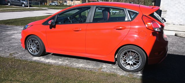

Today I swapped out my winter tires for my new set of Continental ECS 02 in 205/45/16. My old tires were Firestone Indy 500s and so my comparison is based on my memory from last fall.
I think I really like them. I've had 200TW tires for other cars in the past, but I've never had a premium normal summer tire before. There's an increase of grip and tires seem very forgiving at the limit and the limit is higher. I can put the power down more easily... Feels almost like I closed some of the gap between how the car was with the old tires and what a LSD might do. ;) Braking seems better too. Objectively, my last two cars could stop faster than the FiST, I don't know if I can tell the difference now.
I'm surprised how much the ride improved. I went down a bumpy road that I'm familiar with and it was significantly better. I've always thought of the FiST as crude, but it feels much more refined.
I think the Indy 500s might have been a bit quicker when you initially turn in.
Price was pretty reasonable. $822 CDN with 13% sales tax after rebate. That $602 US. Had them mounted for $95 cash and sold my old worn out tires for $60.
