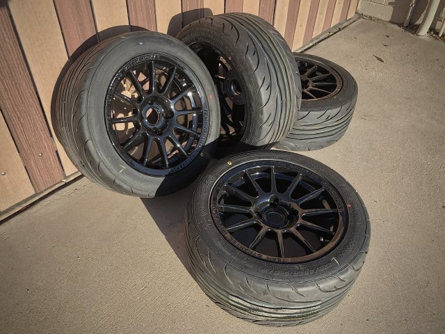

Got two new sets of tires for the 15” rims, perhaps interesting to post about the Nankang tires.
Where I learned a little bit bout these... so Lou Gigliotti sold his company last year (LG Motorsports -- Corvette race car stuff) but recently started importing Nankang race tires. He posted on his FB page about getting a huge container of tires,so I thought I’d check it out. There are a few varieties, but for most of us the 200 TW would last on the street and should provide decent performance.

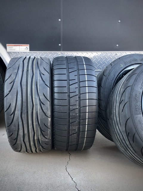

Since I have a new set of BFG Rival S 1.5 here’s a comparison side by side:
BFG Rival S1.5
225/45R15
Stack of 4 tires: 36.2” (9”)
Bead width unmounted 7.8”
Weight stack of 4: 85.4 lbs (21.4 each)
Nankang NS-2R
225/45R15
Stack of 4 tires: 36.3” (9”)
Bead width unmounted 8.1”
Weight each 22.4 lbs
BFG cost $722.76 to my door TireRack
NS-2R cost $580 to my door G2
Will provide more detail and opinion perhaps, may take a month or more with the current situation/ nonsense

Some people may have clearance issues... slightly taller and more treadwidth than the BFG and wider tread than the Toyo 225/45R16 (the Nankang is 225/45R15) 4D026D7D-F168-4389-90A2-DACB91E5C700.jpeg 5EFB9323-1688-4E0B-916A-2A3894640A38.jpeg
