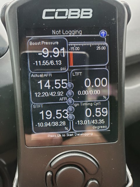

So I went back to a stock tune and the good news is the LTFTs are at 0, but I'm still getting spikes from the AFR. Not sure if that's something to worry about or not.

Well the LTFT data must have not been calculating or something as its back up to 13%.

The AFR's going to 40+ after lifting is normal. You aren't on the gas, therefore no gas is being injected and it's "lean". Log/monitor the STFT at WOT and it should hover close to 0%. Generally +-5% is ok. Also, the LTFT is an average number over time, if you flashed a new map the ECU now has to relearn the fueling trims. If it is still hopping around after 20-30 miles you likely have a leak somewhere
