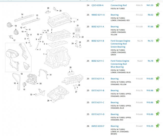

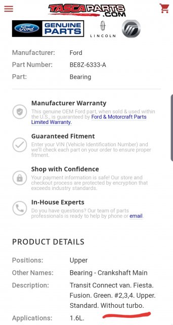

However still can't find main bearings for 1.6 DI Ecoboost Turbo. All rod bearings show as "With Turbo", but all the mains are showing "Without Turbo" (even when Fiesta ST has been chosen).
Any suggestions?

After some investigation it seems that all Fords with 1.25-1.6 engines in the last 10 years use the same main bearings. Housing is 54mm and crank journal is 48mm. King for example offers aftermarket ones, both normal and racing versions: http://www.king-catalog.com/Catalog/Set/MB5009XP
