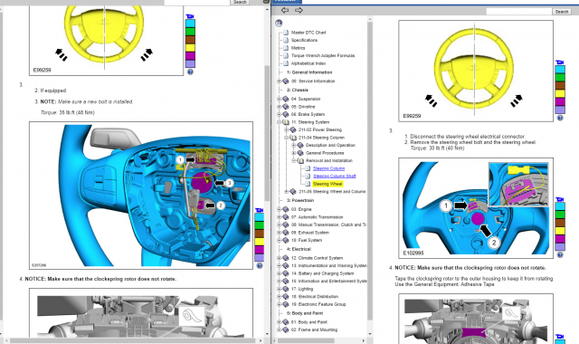

I was intrigued by the thought of this. No idea on the buttons that are on the mk8 wheel vs. the mk7.5 wheel. Pulled both up in the service manual and they are similar. I feel like they could be swapped with splicing in a connector for the mk7.5, but don't take my work on it. The mk8 may share the same platform as the EcoSport too, but I see so few of them in the shop.
