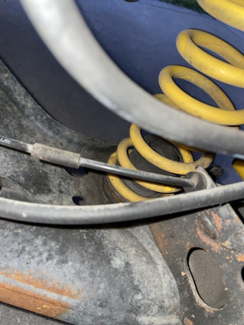

I was working on the rear springs by removing the Yellow Speeds and I'm not sure how to get the springs out. Looks like for the yellow speeds, the spring adjuster is seated against the lower arm and bolted from below. I removed the bolt so I could get the spring adjuster out, but it's just not budging...
Does this mean I need to get a spring compressor? Any recommendations there? And when I install the Bilstein B14 rear springs, I'll need to get the OEM spring seats to seat the bottom?
I have foam pads that are supposed to go on top, but if the adjuster is on top, then can I still use the foam pads?

You should remove the shock bolts (lower) and drop the entire torsion beam. The springs should then fallout out as this allows the torsion bar to drop far enough.
Ok, thanks. I’ll try that.
Does anyone know if it’s ok to put the spring pad on top of the adjuster, against the body?
