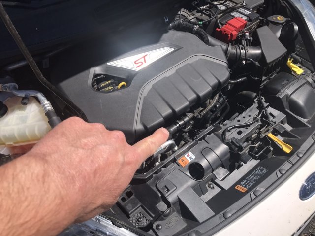

All better!
I fat fingered one of the quick disconnects on the intake manifold post radiator install. Looked okay at a glance, but it was not latched. Doh!
Now the Fiesta is back to being festive.

Thanks for pointing that out - I've had some lacking boost since installing my catch can, and I looked at the hose connections in the picture above. One of the clasping mishimoto connectors on the end was on wrong, I had to twist it to latch correctly. I suppose I'll see if it's better tomorrow.
