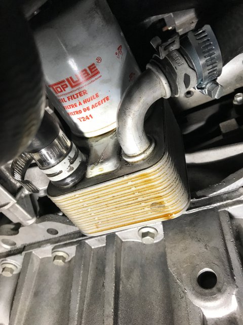

Hello peeps, noticed a couple drops of oil in my garage, looks like it is coming from 2 different places, one is from the oil filter /oil cooler area, the second one seems to be coming from the gear box area, I read somewhere that the gear box vent could be installed backwards, my other question is that I would like to know if there is like a return line that plugs to the bottom of the stock air box, i can see a nipple but no hose attached to it, any help would be greatly appreciated.

Sounds like your tranny is leaking. At the side the transmission are 2 exit holes that leave out from the slave cylinder. You have a line in and a bleeder nipple. Both of this are located under the battery very close to the airbox. You could have a leak at either of those points due to a bad slave cylinder. The slave cylinder replaces both these when you replace the part. Also, it's very possible you have leak by coming from your oil cooler/filter due to age but I'm not sure how often this happens. I'm almost positive there's a gasket on the back side of the cooler but first, when did you do your last oil change and did you wipe some of the old oil onto the filter gasket?

Thank you Rocketst, so to replace the slave cylinder the tranny needs to come out! I checked the fluid in the brake reservoir and it is not low , but I will add some and keep an eye on it, but yes the top of the gear box where the shifter is, is really caked and fluid. On a different subject I do not see any oil coming down from the filter, I always use old oil on the new filter at the gasket, I replaced the oil and filter around 500 miles ago, I cleaned the oil cooler but it is obviously leaking since the bottom of it is oily, how many hours of labor do you think will be to get the slave cylinder replaced? cost approximately? thank you for your help, I had many Subarus, this is my second Ford, seems like my Subarus were so much easier to work on.

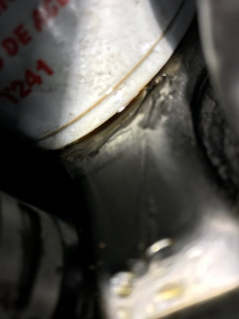

Update, the oil filter was leaking at the base , it was not the oil cooler o-ring, so that leak is taking care of, now I topped of the brake reservoir, drove 60 miles, fluid did not go down but the gearbox is drenched and soaked with oil, looks like is coming from the back side of the gearbox, down around the output axle shaft seal, tomorrow I will be removing the airbox and looking for the gear box vent, I have not loose any pressure at the clutch pedal, hope is not the slave cylinder as mentioned by Rocketst. What connects to the nipple at the bottom of the airbox? is it a drain for the air box?

Lots of oil on that cooler. You should get a new filter because that one looks overtightened and looks like it's crushing its own gasket. It's looks like it's sandwiched. I'd also check the cooler threads and make sure they are good to go.
already changed the oil filter, that leak is taking cared of, the other leak I will have to find...
