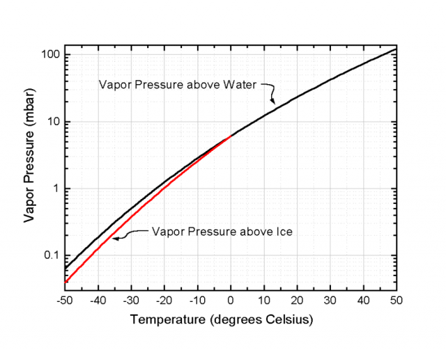

Sort of, water boils at 212 degrees F at sea level. But water's boiling temperature is highly dependent on atmospheric pressure. I think water boils ~200 degrees F at ~6,250' MSL. Below boiling, water can evaporate at much lower temperatures to varying degrees. Water in its solid form (frozen) can even evaporate at very slow rates.
