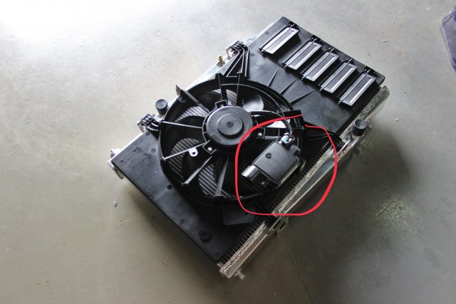

Have you checked the relay on the bottom of the fan shroud? They sometimes melt which causes the fans not to kick on.
Also took this from another overheating thread:
"Did you try turning on the AC to max?
This should cause the fan to run.
This way you prove the high speed fan works.
Running the car with the coolant cap off will cause the engine to heat up faster.
This way you can see if the low speed fan runs.
BTW: there is only one fan motor, the speeds are controlled by the fan relay/module "
