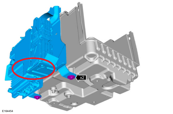

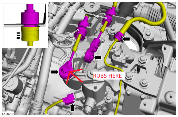

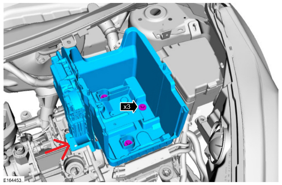

An update of sorts. Shifting into 2nd has been a bit rough, so I went to adjust the cables. I looked closely and the top of the gear selector cable end was up against a tab on the battery box (tab holds the plastic cover secure that is over the computer). I took some vice grips and bent the tab up a bit to give it a couple mm of space. Guessing the Boomba shift kit raised it up just a tad too much. Coupled with the motor moving around due to the sloppy motor mount, the tab could very well have been grabbing the cable and pulling it out of gear on hard breaking. Autocross this weekend so I should be able to get it figured out soon.

It may be a bit before I get back to that spot, Been working more OT hours than regular time for the last month. Below are some pics from the manual.
