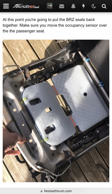

Awesome thank you! I think I need the pad under the cushion and the connector attached to it. Trying to find a picture now. It should have a little tube connected to it.
Found this pic in another thread. I think it looks like this:

Jabbit’s got me! Pretty sure I’ll be able to make it work correctly using his part. I found airbag360.com too but not sure if they can make one for the Fiesta. I know a lot of people don’t care and use tape or leave it lit but I have the time to do it correctly.
