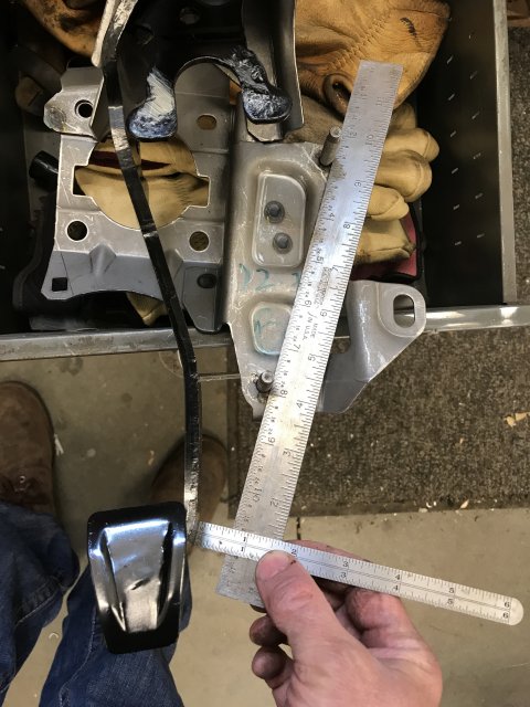

The garage line spacer should be waiting for me this weekend. Plus I ordered up a new brake pedal assembly from Ford that I can pick up on Friday. I’m going to see if I can put the arm of the brake pedal in a press brake and offset it about 5/8” towards the clutch pedal.

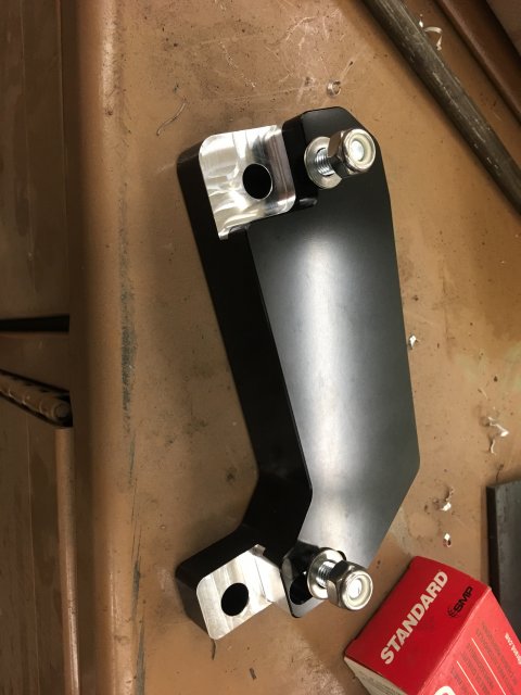

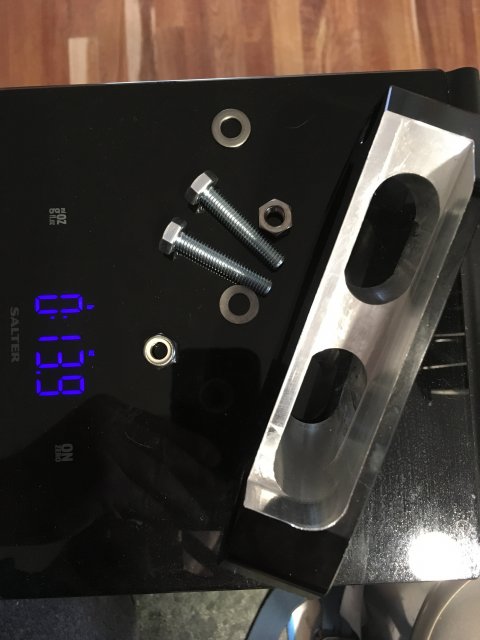

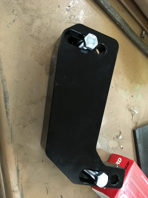

I have the garageline spacer. The freaking thing weighs 1# 7oz!!!!

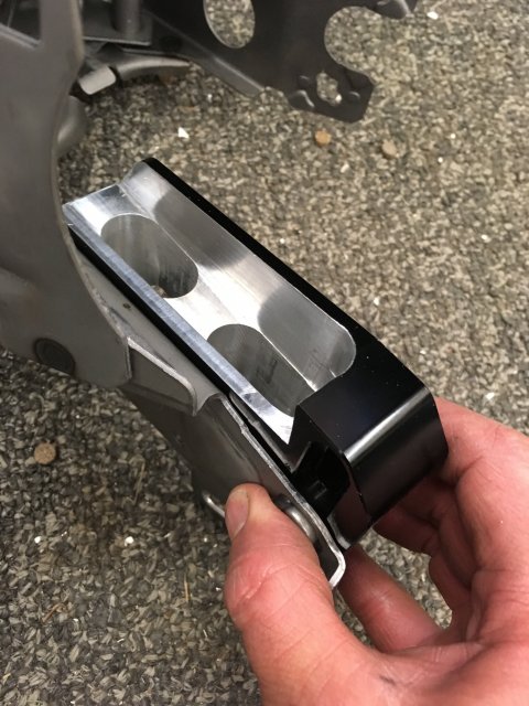

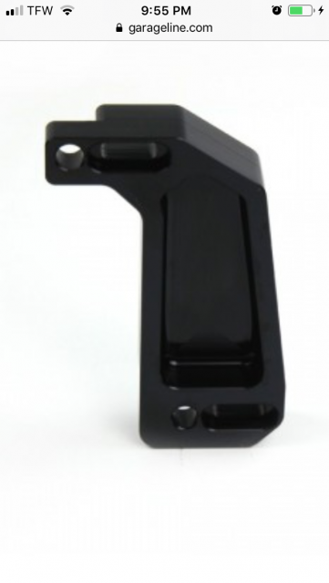

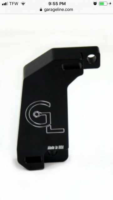

Did not match the product shown on their website at all - some rookie looking CNC, like a 2nd operation on the mounting ears after anodizing.... and no pocket in the back side to save weight.... even though the pocket is clearly shown on their website.
Hopefully I hear back tomorrow - If I end up keeping this one I’m going to slap it on the mill and put it on a diet. 3DFF7875-2BE0-4171-BE12-E4104F008315.jpeg 11B0150D-F037-45DB-AC8F-5182F95E23C8.jpeg

I am still able to pull this up via their web page and under fiesta. I'm really surprised the spacer received looks so lack luster. I was getting ready to buy one but now might hold off?

Let’s start with the Garageline accelerator pedal spacer. I like it, but since it is a solid chunk of aluminum it is not light. 1 pound 7 oz with hardware. Garageline got back to me about the spacer, and they said the weight reduction pocket was eliminated on the back because of “rocking” issues. Also said they eliminated the laser etching to save money. No mention of why the mounting ears were machined post anodizing. Overall okay- just would like them to update their website - and consider other ways to get the spacer lighter.
I bought an entire brake pedal assembly from Fomoco, complete with accelerator pedal mount. I can see how what Garageline did with the rear weight reduction pocket had the potential to not be supported and possibly rock.
I milled away on the spacer until I got it under a pound. There is a hell of a lot of aluminum that isn’t doing anything but making the spacer heavier.

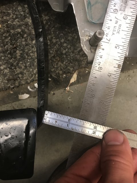

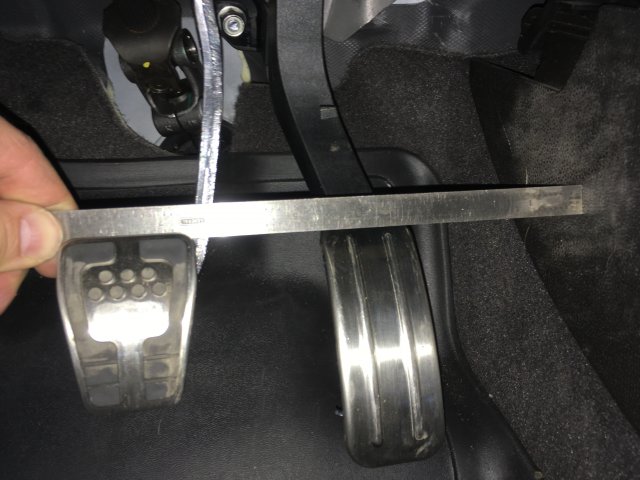

Took the brake pedal out of the new pedal assembly I bought and took it to the press. Was able to offset it towards the clutch pedal about 3/4” without too much trouble, that should give me enough room to wear my work boots.

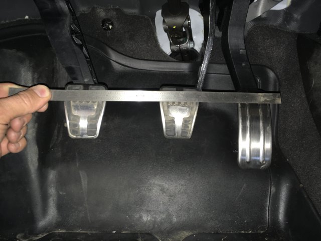

Overall width from outside edge of clutch to outside edge of accelerator is a little under 10”. I now have about 6.5” from the top inside edge of the brake pedal to the center hump of the car. I have not tried it with my work boots yet but I think it will be good enough!
