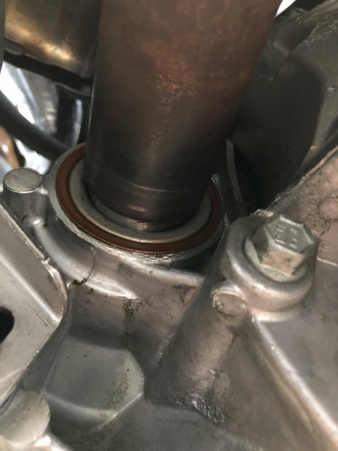

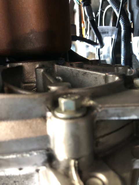

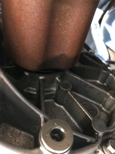

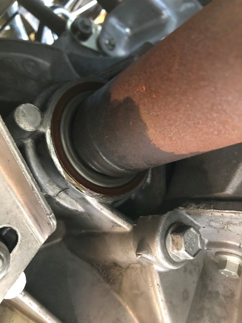

Noticed thise while under the car doing my radiator job. If you look close, the pic of the passenger side of the trans, that is accumulated fluid on the lip of the trans just past the bearing and seal.
Quick facts: car has been sitting about a week, its been on jackstands in the front for about 4 days. 8500 miles, trans fluid has never been changed as far as I know (not surprising for 8500 miles). I bought the car at 7500 miles in Feb.
The original 3 yr/36k is up as the car was originally registered March of '17 but I'm still in the 5 year powertrain and I also bought an extended warranty when I got it (from a Ford dealer so Ford warranty).
Questions: does it looks like failed / leaking seals? If so, will the dealer try to deny me a claim since I have a RMM installed? Will they hassle me for the other parts I have installed (IC, Mountune rad, wheels, short shift kit, boost hoses)?

Its weeping for sure. I would bring it in....But the next seal is as only as good as the installer. Some people have had them done multiple times due to most likely the same shitty tech installing them incorrectly. I had mine done and they still look just fine. I spoke with the Tech who was working on mine and he said he has fixed numerous comeback from other Techs not doing them correctly. Good luck!
Hmm alright then, thanks for the response. What say you about the aftermarket parts?

I'd been told there was a revised seal also....I'm not 100% what the part number was though. You could always ask then. But maybe they were blowing smoke

Got my appointment set for Tuesday morning to take it in. Fingers crossed they don't try to hassle me for the mods :rolleyes:

Just got a call from the dealer, no issue on warranty coverage under 5yr powertrain. They only had 1 of the 2 seals in stock, but should be done tomorrow. So I guess only thing remaining to be seen is how good of a job they do on the install.

Got it back yesterday, it seems good. I got under the car as soon as I got home. I cleaned up the area of spilled / excess fluid from the install and I’ll check again in, I dunno, 100 miles or so to make sure the leak is actually fixed. But it does look ok for now.
