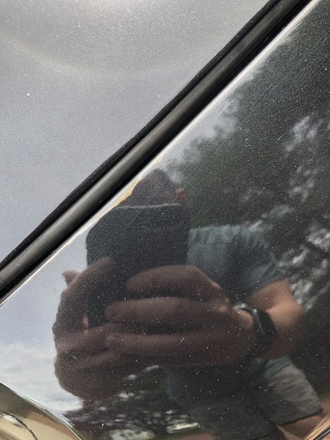

I’m considering some form of paint protection after incurring my first minor nick on the front fender.
How does the more modern film, such as xpel, hold up over the years – does it yellow or crack with age like some of the older material did? My car generally always garaged and well taken care of.
At some point as it begins to age, will removal ruin the notoriously thin paint?
I’m just weighing my options – I’m particular about my vehicles, however the cost for PPF and the potential for reapplication and paint damage during removal is a concern when factoring in the relatively low cost of the vehicle.
Thoughts?

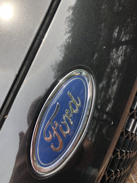

Hey,
I had my front bumper covered with xpel when the car was 200 miles old. This August it will be 5 years, and the car has about 56k miles now.
The good -
-The bumper definitely looks significantly better than it would if it was never wrapped.
-It doesn’t need to be detailed. It’s virtually impossible to scratch, unless the film is perforated.
-There are NO signs of yellowing.
-It’s very discreet. I can see the seams, but nobody has noticed before.
The bad -
-It’s not quite as tough as I would like. It does have rock chips in it.
-The corners are starting to show signs of lifting up.
-It is easy for wax to make it’s way under the edges if you apply by machine (rotary polisher or similar).
I’ll post some pictures later today, as I am finishing detailing today, hopefully.
