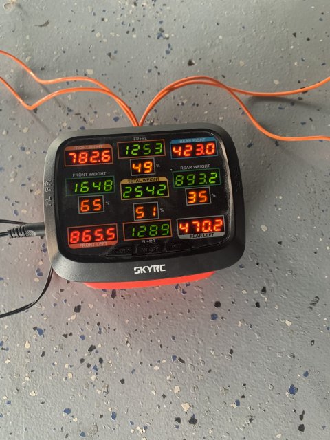

I have the rear seat back, shelf, spare, tools, belts, brackets, wiper and sound deadening removed and the balance came out to 65/35 with half a tank. Not too bad and the car doesn’t feel any more tail happy than it did before IMO
Edit: Picture attached is WITHOUT the wheels on the car. I run a 16x8 Dekagram/RS-Pro setup so around 130lbs?

You can fix this with corner balancing I believe though, to some extent. But yeah for sure I agree.
