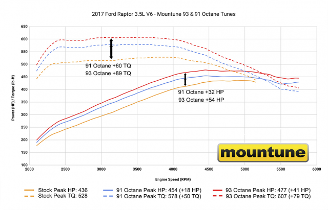

There's even a difference between 91 and 93, according to mountune.

The more octane a fuel has the harder it is to combust. This means timing can be advanced closer to TDC thus making more power on the power stroke. 🌈🌈🌈

Yeah this isn't really a case of the gas being better, it's just that the vehicle's computer can run more aggressive timing and "tune" overall to utilize the higher octane fuel.
The FiST? I run 93 all day long as it can utilize the higher octane fuel. My '99 4runner however, gets 87. No matter how many tanks of 93 I've run back to back I've never been able to "feel" a difference nor see a difference in the fuel economy in the 4runner. I say just run whatever your manual calls for and call it good (in the case of aftermarket tuning, run the highest octane you can find)
