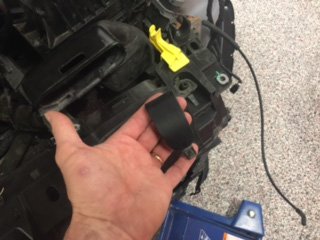

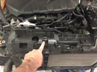

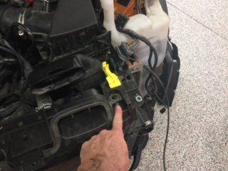

Ok, discovered there are two removable tabs at the top of the radiator support which must be removed and the rubber grommets beneath also have to be removed, then the entire assembly can be removed WITHOUT disconnect either radiator hose, or AC condenser. There are a few wire ties which must be cut for the hood open sensor, and the hood release cable, and latch assembly must be disconnected and removed too. Rad 1.jpg Rad 2.jpg Rad 3.jpg

Ok, discovered there are two removable tabs at the top of the radiator support which must be removed and the rubber grommets beneath also have to be removed, then the entire assembly can be removed WITHOUT disconnect either radiator hose, or AC condenser. There are a few wire ties which must be cut for the hood open sensor, and the hood release cable, and latch assembly must be disconnected and removed too. View attachment 39635 View attachment 39636 View attachment 39637
Ah you discovered what I was going to mention and the fact that if one is careful and has a pair of spare buckets they can remove it attached and rest it upright on them as to not disturb the connections we did this on my rad and intercooler install except we left the core attached to the crash bar and separated the whole assembly from the front of the car in one piece. It made putting the radiator in a piece of cake and was only 4 bolts more after the intercooler.
