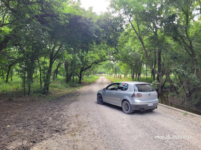

FWIW on my Rally/Autocross MK5 Rabbit project I overhauled the suspension with OEM spec springs and Bilstein B4 shocks. I was going to go with B6s, but was a little worried they wouldn't be as compliant as I would have liked. I have B6s on my Fiesta, and they're a bit stiff on the damping. The car still handles great on road and rides great on the rally cross courses and on my local gravel/dirt roads I go tooling around on sometimes. Nearly all of our county roads are still gravel/dirt around here.
My biggest performance difference was going to Ice/Snow tires FALKEN WINTERPEAK F-ICE 1. They're not "rally" tires but compared to my street tires offer freakin awesome grip on the dirt and gravel. Plus side on the Rabbit is, in it's factory 15 inch tire size they're 80-90 dollars a tire, I put them on a set of steel wheels and swap them on for rowdy back road drives and rallycross.
