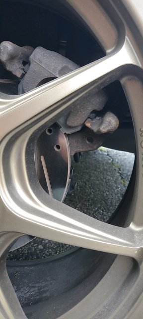

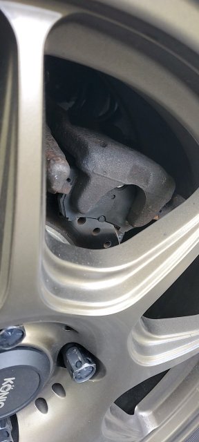

Strange thing happened to me. Heard a scraping from one of my rear brakes. Take a look and
??? Apparently this guy came loose somehow and is now gone. Autozone has nothing in the system for this bolt and can't find any documentation on the specifications on this bolt. The dealer doesn't have any in and would like to resolve this quicker than the delivery of the bolt. Does anyone have the details on these bolts so that I can make a run to autozone/hardware and just buy a bolt and properly locktite this one? lol

Huh. I believe they're chrome'd on the threads and blue loctite'd from factory. When was this caliper bracket last serviced?

You guys rock. Thanks for the help. I put camber plates in last week and it looks like I missed torquing a bolt. Thankfully I work from home. Haven't really driven anywhere. Only noticed as I was driving to the convenience store and heard a nasty scraping. I was looking to just pick up a bolt and take care of it but no site seems to say the spec on these bolts so I bought them from Ford online. Thanks for the tip.
