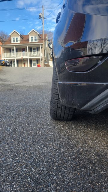

So I installed some rear camber plates. I thought, "hey, it's a street car so leave in the dust shields".

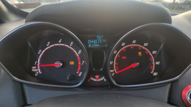

Well I figured out why you have yo remove them. It increases the gap too much between the sensor and ring, therefore you will not have abs.
Figured it would be handy foe peeps to know why you have to remove the shields.
