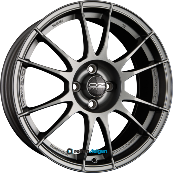

OZ Ultraleggera 15s:

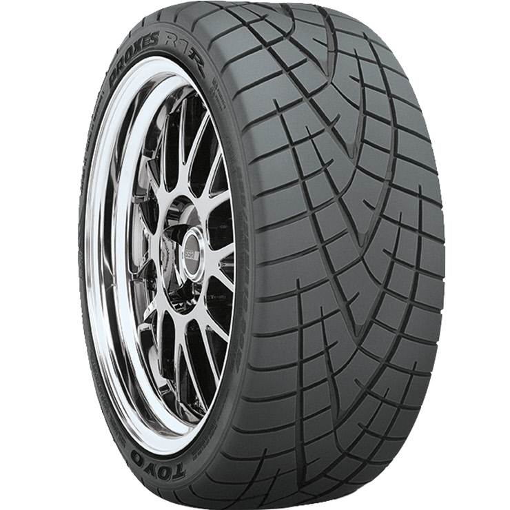

Toyo Proxes R1R 225/45/15:

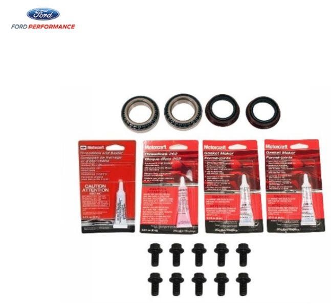

Ford Performance Differential Install Kit:

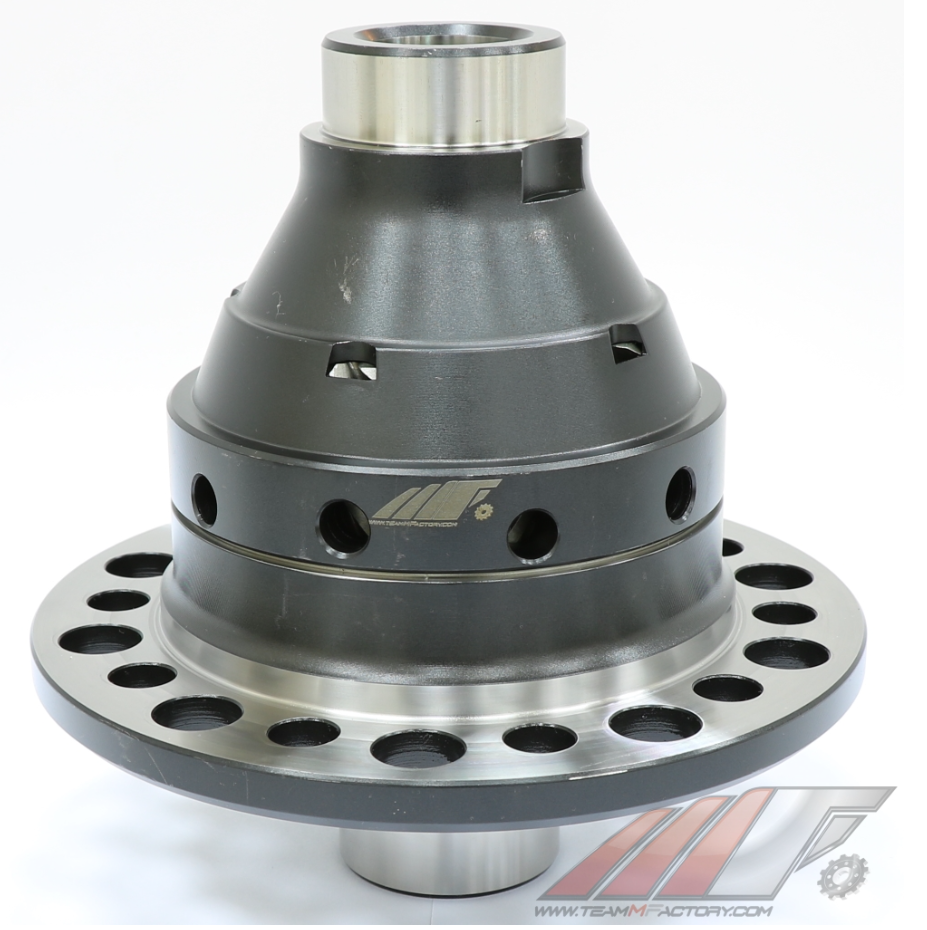

MFactory Limited Slip Differential

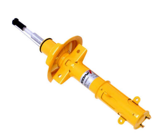

Koni Sport Front Shocks:
Koni Sport Rear Shocks:

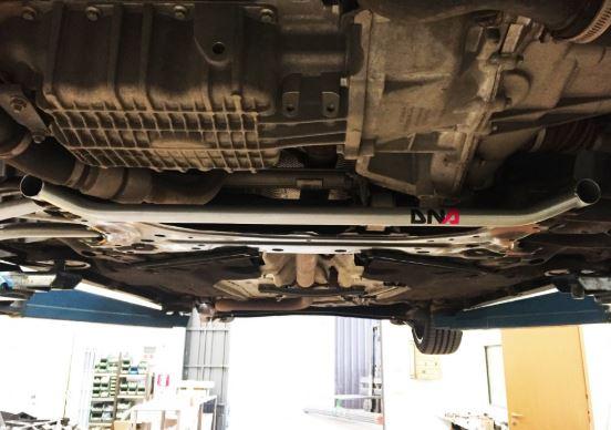

DNA Racing Subframe Brace (6 point):
DNA Racing Subframe Bar (2 point):

-Front and rear Koni Sport (yellow) shocks

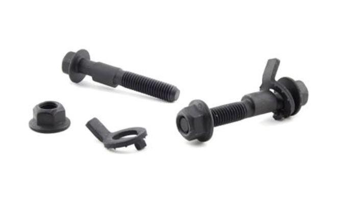

-Whiteline front camber bolts

-DNA Racing bottom subframe stiffening brace (6 point)
-DNA Racing front subframe stiffening bar (2 point)

-MFactory limited slip differential
-OEM slave cylinder

-OZ Ultraleggera 15x7 wheels (42 pounds lighter than stock)
-OEM slave cylinder

-Koni Sport (yellow) shocks front & rear
-Whiteline front camber bolts with -1.0 degrees dialed in

-OZ Ultraleggera 15x7 wheels installed
-Toyo Proxes R1R tires installed

-Local tuner to install DNA Racing 2 point subframe bar and 6 point subframe brace

Well, just got it back from the shop with the shocks, front camber bolts, and rear camber plates installed, and I think I'm going to have to take the rear camber plates back out. For one thing, with the plates I have -2.0°, and -2.2° on the rear wheels, which is more than I wanted for tire wear in a daily driver. Secondly, and most importantly, it triggered by ABS sensor and my traction control sensor, and I'm fairly certain my performance has been degraded quite significantly. I'm not sure if the engine is just in some kind of limp mode or what, but power seems to be down quite a bit.
Without the plates, the rear wheels were -0.4°, and -0.7°, anyway. That'll have to be enough.

So as of today, camber bolts and plates have been installed, Koni Sport (yellow) shocks all around installed, along with requisite alignment.
Also my DNA Racing subframe braces came in and have been installed, and yesterday I got my OZ Ultraleggeras and Toyo Proxes R1R 225/45/15s put on there.
