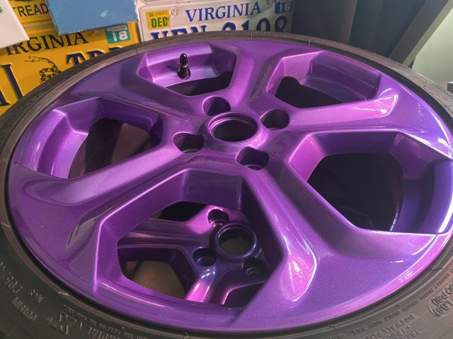

I painted the stock snowflakes myself using an airbrush setup and my experience from this being my full time job. Generally getting them professionally painted will be cheaper (600$ or so) and powdercoating will cost slightly more (800$ or so)
The difference is getting them professionally painted, they’ll most likely only paint the face of the wheel and leave the barrel unpainted. Whereas a powder coat will paint the entire wheel. You might check to see if the company I work for is local, we offer both options. The name is “WheelsOnsite”
