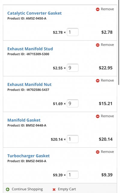

This is my first post. I’ve read all the threads about leaking exhaust manifold gaskets and have done the pressure test with air and bubbles from the turbo back. I haven’t removed the heat shield to inspect the gasket but from what I’ve read it seems to be the issue. Exhaust tapping noise and screeching upon acceleration. Loss of power at higher rpm and gas smell. I was wondering if this shopping list, not including the arp bolt kit I ordered and the anti seize seem to everything I need. I was debating on getting the oil line gaskets but I haven’t read anything about not reusing them. If you guys recommend anything else please advise.Thanks

Just make sure to Torque everything properly and re-check the studs/nuts again in a couple hundred miles.
