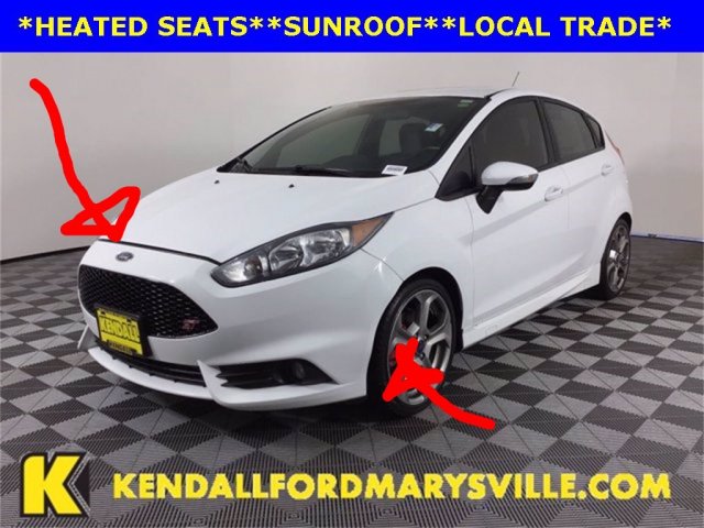

I went to test drive this FiST last night and I noticed that there was some potential front-end damage. It made me wary enough to skip buying it, even though it checks all of my boxes. I didn't feel any handling problems besides the tires being nearly bare.
The damage is around the front bumper where it meets the fender flares. It's more obvious on the drivers side. The "line" is warped. And the gap between the hood and bumper is bigger than I'd expect.
I'd appreciate some thoughts on if this is concerning or not. Otherwise, I'd likely buy the car. If this is concerning, there is another available 3 hours drive away I might check out... we'll see!

I don't like the look of it, it looks like a non oem bumper, I did a bit of editing in paint to show you what I mean. It probably has a few secrets, or could just be a bumper issue that happened and they bought the cheapest replacement and that's why it fits like that hard to say... It's also 60k miles for 13k
See how one is circular and the other is not? I believe it's a non OEM bumper probably a cheap replacement that was painted.

Use a flashlight to inspect the front crash beam. Is it bent downward or bent at all? The whole front bumper/cover is one unit so if it is sagging (what it look like) check that the fasteners are all in place and the holes aren't ovaled or broken out. Looks like the hood is in the right place. 1615072403264.png

That picture immediately above is no a Fiesta ST. As far as the first post yeah something looks off.

The thoughts on the bumper being replaced are interesting. I definitely checked for any broken plastic tabs and "ovaled" holes but didn't notice anything. The fact that the bumper was replaced non-OEM would explain it! That's what made me want to post here -- I was confused and uncertain about what the cause could be.

If ths grille support that clips to the bumper beam is broken the whole nose will sag like that. Doesnt take much to break it either. Im gonna be on my 3rd grille if i bother to replace it AGAIN 😞
