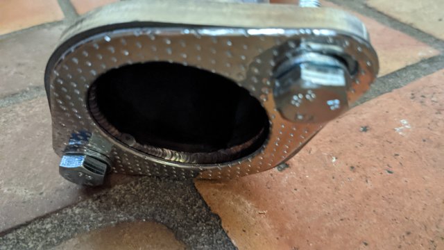

below is a picture of what came in. Note the flange is perfect and flat, a reflection in the picture below make it look odd.
It looked well made and the flange was Tig welded for a good seal.

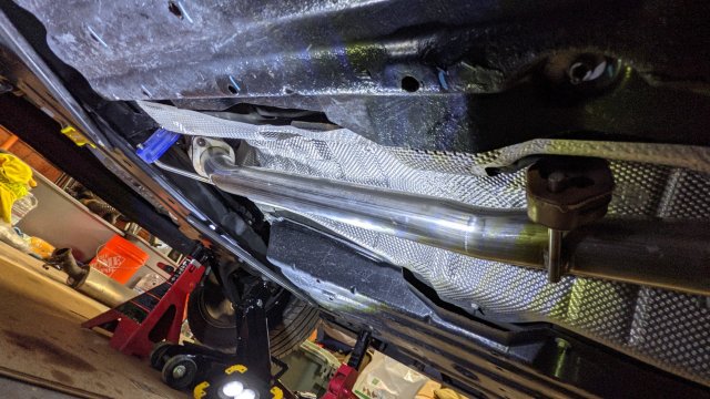

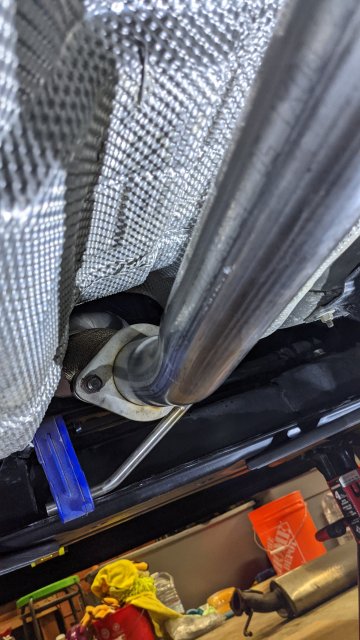

Now i had to take off my resonator. I was working from jack stands and lifted the car as high as i could with my floor jack.
the thing that took the most time was the bolts on the exhaust flange. I did not want to destroy the studs. The nuts were very badly rusted and rounded off. From the look of it the studs on the stock manifold were stainless steel. i considered a number of ways to handle these nuts. and went out and bought some rounded nut extractors from sears. they did not work at all.
In the end i found taking my dremel tool with a small cut off wheel is what worked the best. I cut a slit in the side of the nuts and used a small chisel to get them off. I tried as best as i could not to damage the stud. In the end it worked well, i did mess up the threads a bit but i just chased them with a die to fix them. By the way the nut is 7/16 -14. I replaced them with brass nuts so i would not have this problem in the future again. note - never never never use stainless nuts on a stainless stud. you will not get them off.

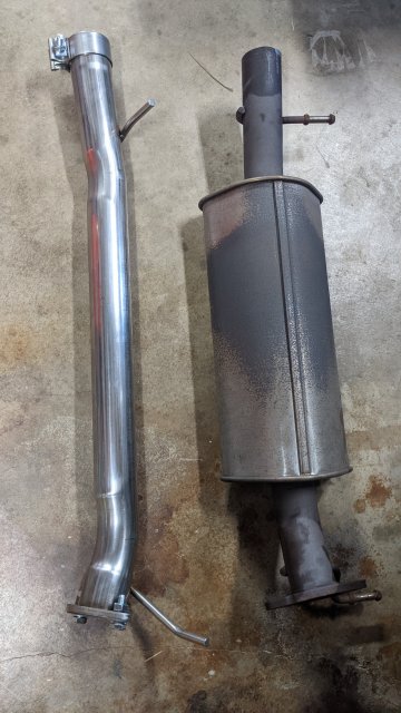

Now to cut the pipe. you cut it 7cm in front of the front hanger, the vendor is nice enough to show you a picture on ebay were to cut it. i used one of the chain type cutters (free rental from local auto parts center). it cut the pipe like butter. it sliced it within 2-3 min. if you use this method to cut it, remember to oil the chain well, it makes it cut much easier.
Here are the parts side by side

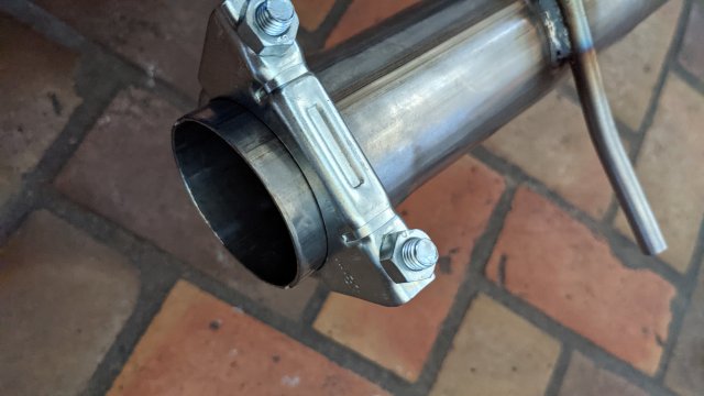

then it was just a simple matter of bolting up the new part. The vendor includes a pipe clamp that works fine. its not stainless and i may upgrade that in the future but its not leaking. a gasket is also included and i used it. I did not need his bolts / nuts as i used the stock studs with new brass nuts.
