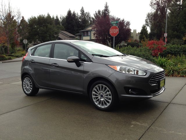

This probably isn't the best idea to move forward with, however it is an idea. You could go the route of putting the base fiesta hatch springs and dampers on the car (the setup from an SE). This would probably raise the car quite a bit, and change the handling characteristics as well, I would assume it makes the car handle much more similar to a base model fiesta (not really what your looking for). That is if a new set of dampers does not solve your current problem.
It will look like this but it definitely rode like butter.
It actually did some downhill curvy parkways pretty well but you won’t be able to toss it around. Now, correct me if I’m wrong but won’t there be extra turbulence underneath? Also looks kinda of like a mini SUV.
