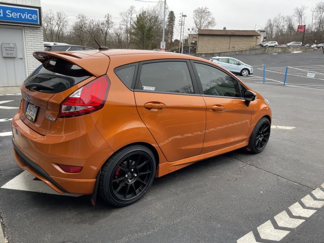

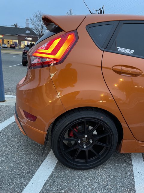

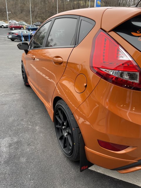

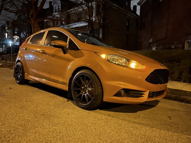

hey y’all I usually lurk but figured I’d post up now that the wheels are finally on. Here’s my baby.
2018 Fiesta ST
Rota Titan 17x8 +40 w/ hub centric rings, Falken Azenis R615K+ 215/40/17
Cobb HF2 Induction Kit
Turbosmart EM2 BPV
Turbo Technics S280 Turbo
Cobb Catted DP
Resonator delete, stock exhaust
Whoosh V1 FMIC
TunePlus+ Tuned, 27psi, 274whp/314wtq on a Mustang Dyno, stock fuel but about to get aux fuel next week

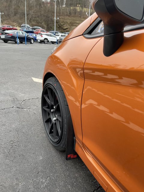

Stock suspension, no rubbing
I wouldn’t have had the confidence to do all the work I’ve done on the car so far without the vast resource that is this forum. So thank all of you for being the beta testers for what works and doesn’t work on these cars, cuz that helped me get it where it is today. Much respect

Alloy.. not sure what kind but they’re Rays. Collectively they weigh less than one single stock nut lol
