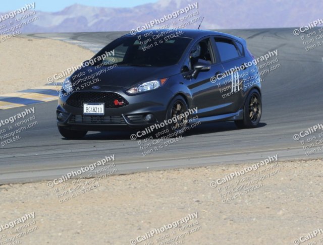

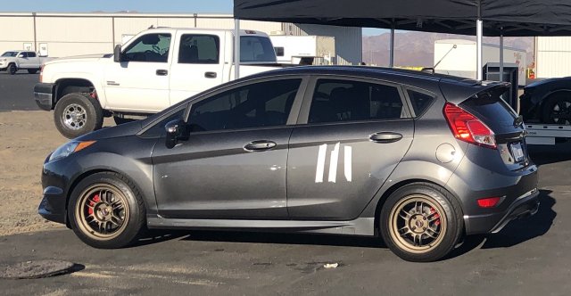

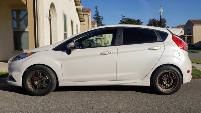

People generally run 205-225 / 45 / 16 on 16x8. 205 has by far the most options.
As far as tire choice, really depends on what your goals are w/ the wheel setup. Sporty daily? Autocross? Big track?
