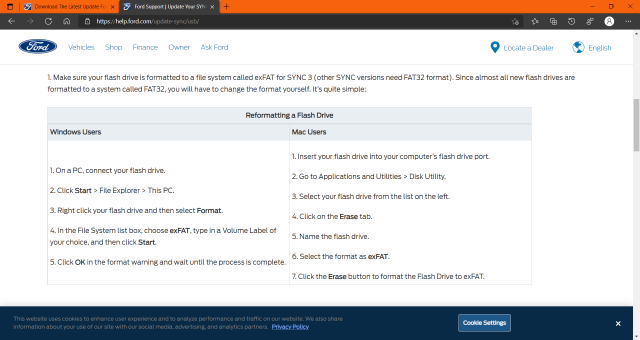

Please check this.
It is exfat that the Ford site says how the USB must be formatted for Sync 3.
I did have this issue at first until I corrected it by formatting the USB with exfat.
From the Ford site.

Please check this.
From the Ford site.
tried this on mine did everything they told me too . formated exfat.
