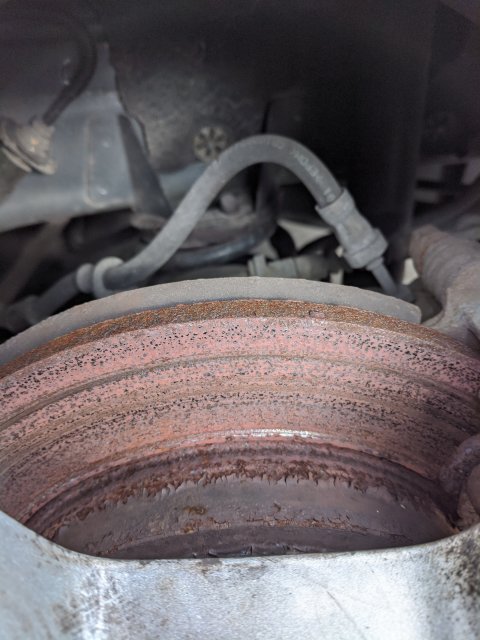

Scraping sound when braking - left rear

looks like both pads and rotors + rear caliper pins are seized. It's common on these cars. When you replace the pads and rotors, you can get work the rusty pins out and clean them up+re-grease them, or get new ones for fairly cheap.

thank you! Any recommendations on which brand/model to purchase?

thank you all! Any idea of torque specs for the brake rotors?

If i recall its 40 ft lbs for the caliper to the spindle, and maybe 16 for the slide pin bolts? Its not major amounts.
