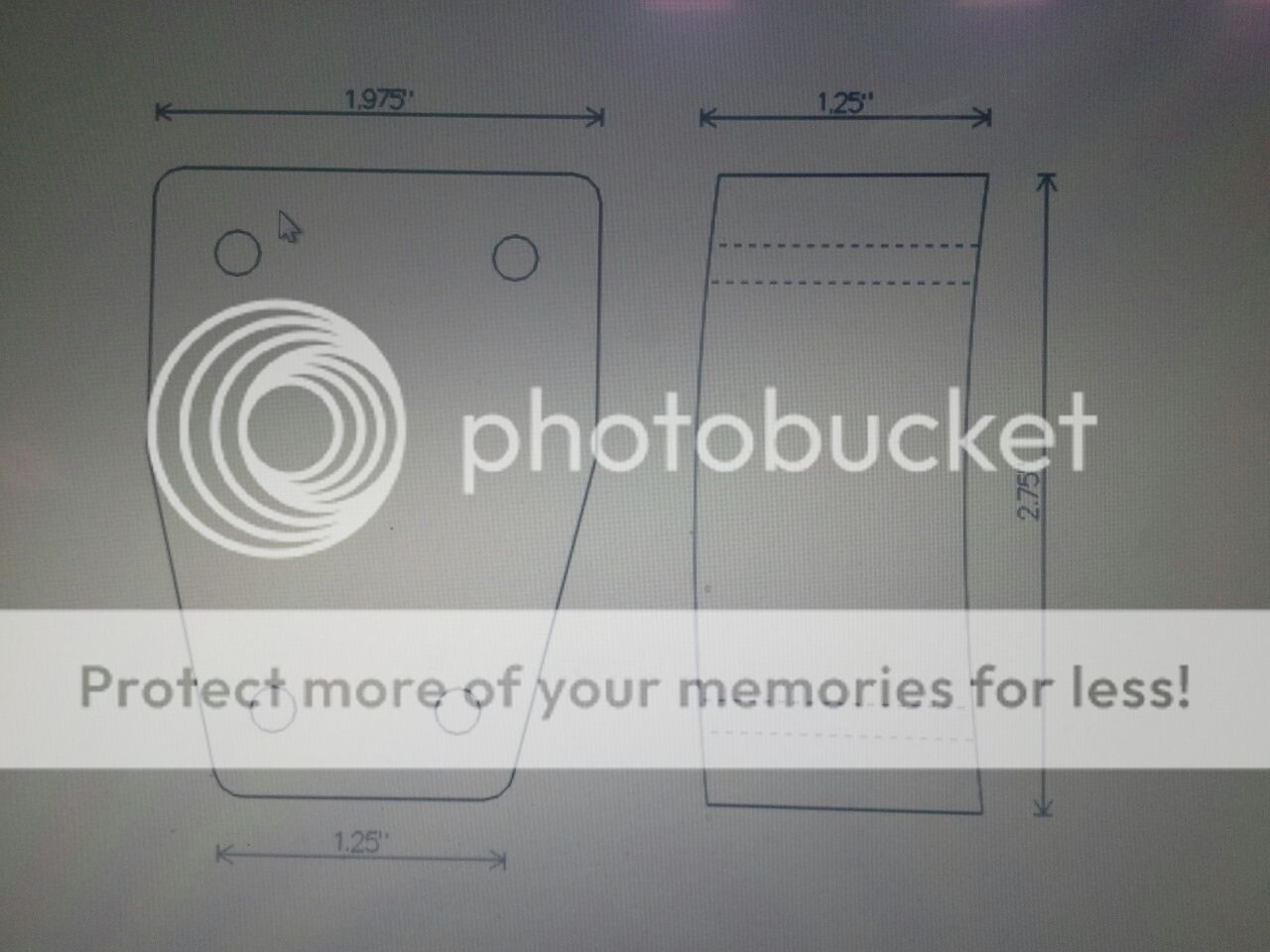

After making a throttle pedal spacer and looking at examples online for Mustangs, etc, I went through the trouble of drawing/fabricating/installing/hating it. I removed the rubber pad and put the spacer between the plastic clutch pedal and the rubber pad. Felt weird. Sounds dumb, but tape a piece of wood to the clutch pedal and try it. I thought it would be great, but didn't like it at all. You might like it, but try a sample before you commit.
