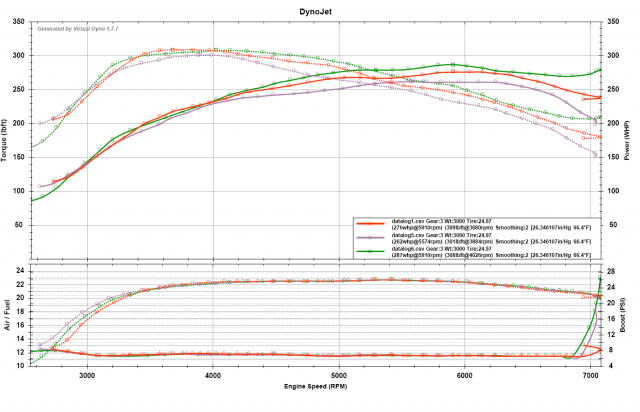

X-47 Turbo - 94 Octane
~270 whp and 300 lbs*ft
X-47R Turbo - 94 Octane
