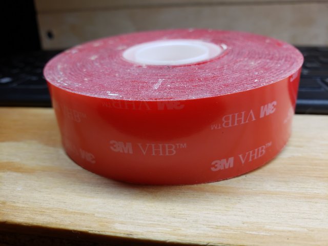

Bumping this because Dave’s solution worked for me as well. I replaced four of the nine clips with the GM version and used 3M tape to secure the ends like they were from the factory. It was actually quite easy to do. Cleaning took the longest. The car looks so much better!

Which 3M tape did you use, the thicker mil foam type (which is usually wider in width, like an inch and a half), or the thinner mil, harder to use because is super sticky, and it tends to 'catch' on itself (which is usually narrower in width, like 5/8")?
