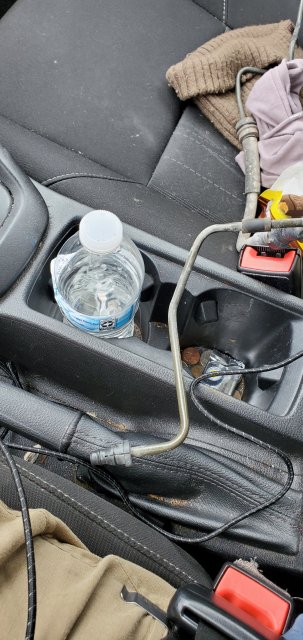

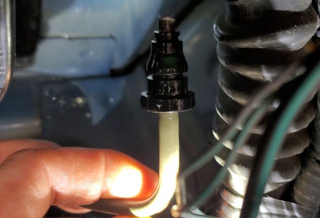

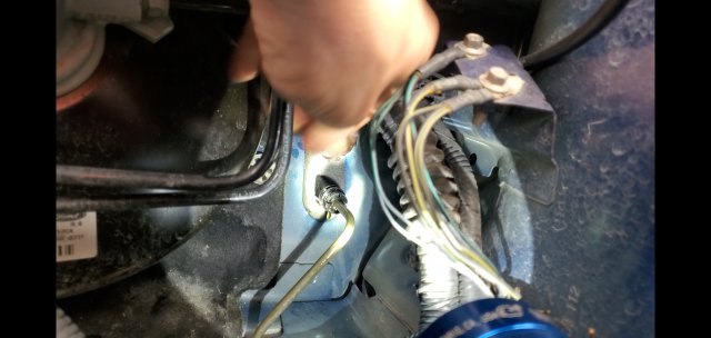

Tech was putting it back together and said the O-ring for the fluid line looked deteriorated....yeah, 2019 w/10k miles. They are replacing the whole line, but they have to get one from a distributor. Than means tomorrow or Wednesday...ugh...they have had it since Thursday @ 13:00. Any other 2019 owners, beware. YMMV
Thats a bunch of baloney. They don't even have "o rings" they have a thick rubber seal that goes between the solid line and the slave. But I highly doubt that little seal is sold separately from the line.
I said o ring since I forgot what the advisor said.

Just had a leaky master replaced by the dealer and the completely left the end seal off. It was leaking bad from the firewall where the lines connect to it.
I'm having the exact same issue after replacing the master cylinder myself and the tip of the line looks the same. How did you fix this? Did you have to get a whole new line, or just replace that tip?
EDIT: For anyone reading this later, looks like the part needed is 7A512B: See on Ford.com

Well I was speaking as in: those things don't go bad / dry out randomly.
Especially in <3 years since mfgr date.
Warranty. Advisor said they were replacing the whole line rather than the seals. I get the car back today, FINALLY. If the tech had inspected it when he disconnected it, they could have ordered the line and had it all done and ready Monday, maybe Tuesday.
