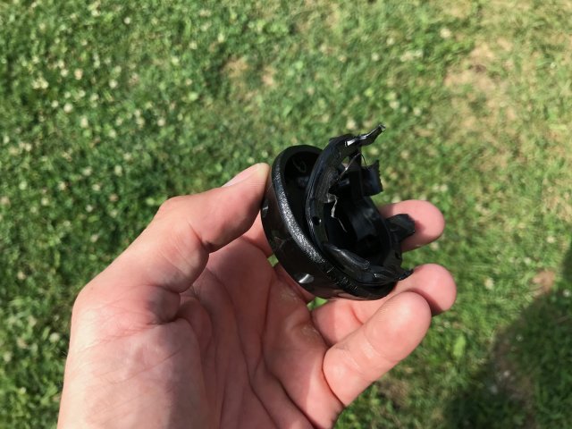

BRAKE DUCTING. Get the temps down no matter what you do. If you melted the center caps, imagine what you did to the brake caliper seals and dust boots? Brake caliper seals are not happy when they start getting over 400deg. What do the boots for your ball joints look like?
