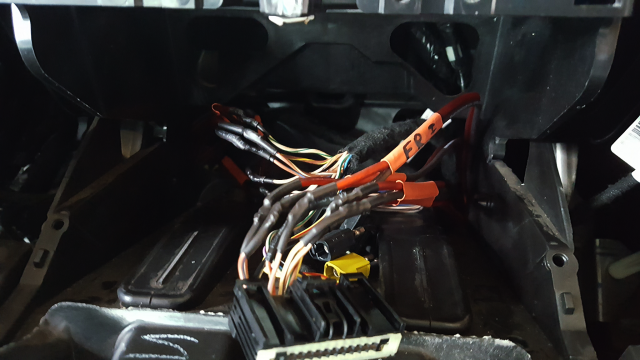

I'm trying to figure out where the speaker wiring comes from. Does it come off of the apim? Because I have what I believed was speaker wire color code but only half of them were back there. I'm in the process of wiring in a dsp

Easiest way by far is pulling the stock unit. I learned this after pulling panel after panel. Just remember to label your wires

Yes it is... However the front left color is very deceiving. Mine was more of a cream and cream/brown. Definitely not white which made me do a double take
