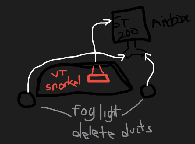

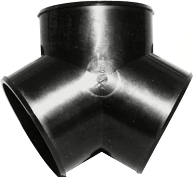

I'm currently running this setup pictured below. I have two silicone pipes connected to each fog light delete duct which route to a Y-pipe connector connected to the bottom of the ST200 air box. I brought it up with Jason from dizzy and he said it may be causing turbulence / uneven air distribution under the filter. I'm wondering if anyone else is running a similar setup. I'm currently in the process of getting my S280 tuned but once it is finished I can try comparing data logs (MAF, AFR) of the current y pipe setup vs a single pipe.
Drew this with a track pad:
Y connector I found on amazon.
