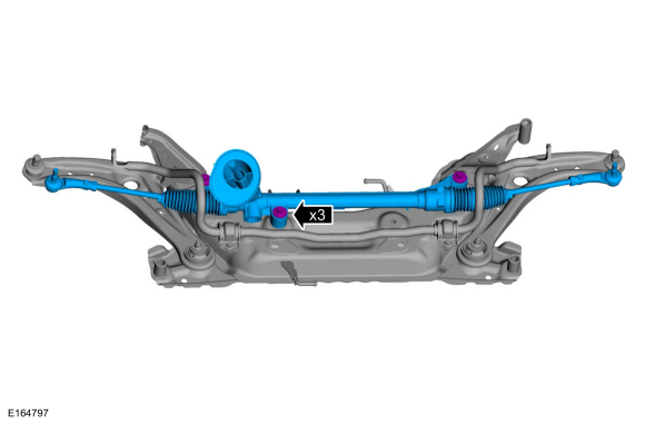

The steering rack is held down to the subframe with 3 hard to access bolts. I had a somewhat similar issue and one of the bolts had worked itself almost completely out. Pop her up on some jackstands and find the 3 bolts.
