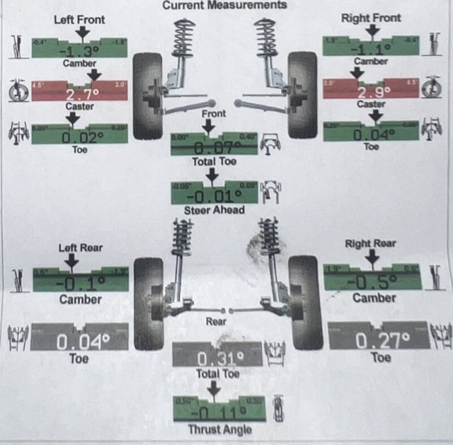

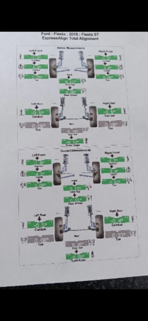

been dealing with an issue with not being able to really control the going straight. so i’ve kinda of just started to replace some parts. superpro control arms (oem spec), Whoosh RMM, replaced steering rack (had blown seals).. got the car to an alignment shop and this is the alignment sheet. car can drive straight but changing lanes and the wheel returning to center after turning feels so sloppy and erratic. could the caster be my issue? it’s not adjustable and if so how would I got about adjusting it?

The alignment sheet looks acceptable, caster is fine but the tech could have shimmed the rear toe to be more even.
What is the condition of your tie rods? Do they have any play?
Does the car pull to one side when on throttle & then the other direction off throttle?

tie rods are brand new. steering rack and tie rods have about 200 miles. steering feels extremely snappy. like if I switch lanes it pulls hard right. switching to left feels fine. hitting bumps on driver side feels fine but hitting on passenger side it kinda like jerks the whole car right. when on throttle or off it is going either direction even cruising feels like I have to constantly control from veering right to left. should also mention with the posted alignment sheet my steering wheel isnt very straight slightly points left.

Your Caster is lower than spec. It's supposed to be 4.08 +/- 1. Another couple of degrees of caster would definitely improve self-centering.
The rear alignment is way off. Unlike the front, where uneven toe left to right can be compensated by turning the steering wheel, at the rear you don't have that option. Real toe spec is 0.0 +/- .50 and they should be the same left and right.

how would I go about getting the caster back to spec if it’s non adjustable. my previous alignment sheet before replacing the steering rack had caster in the right area. also while putting subframe back up I added whoosh subframe centering kit. still have the same struts and control arms.

Removing the centering kit will increase the caster back to standard but it won’t change the behavior you are feeling at all. My caster is at 2 but my car doesn’t behave anything like you describe for yours. It’s not a caster issue you are feeling. There are adjustable caster bushings available, but most rotate out of position. I have a set for a Mazda2 I need to install before I can recommend them.
Rear toe is correctable with a shim. They used it back in the day for VW Rabbits and any respectable alignment tech has them laying around. I am not sure it would be causing the issues you are feeling because I also have uneven rear toe and no issues with the car tracking straight. It’s toed in, which helps with keeping the car stable in a straight line. It’s confusing for sure.
What is the condition of the torsion beam bushings?
