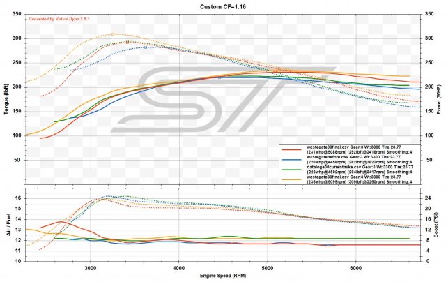

Early 7psi wastegate data, this is for all the owners who have thought about if the wastegate is worth it. This is not apples to apples because the blue line it’s a final tune and red is a base map but the data is excellent
Red line is the base map from Brian Tyson the WGDC is rather low so we got some overhead and the blue line is right before install same day.
3300 pounds is from me and my brother in the car
We did get a revision last night but weather is terrible can’t do any logs so I’ll report back
I got even more interesting data
At 6600rpm on the 7psi wastegate he’s at 13.2 psi and 66 wgdc
On the stock wastegate he’s at 12.9psi and 77 wgdc
And he’s still making more power
Airflow mass lb/min on stock is 20.54 at 6600
On the 7psi wastegate is 21.3
So it’s going to get really interesting, probably 10whp across the whole curve and a nice gain in tq for 138 bucks

Here we have revision number 3 and it’s not even close up top one graph is 93 and other is e30. I’m shocked we hit 240whp on e30, but it’s pulling so damn hard it’s not even funny. We aren’t done yet we are at 24psi and at redline it’s up 2psi at 14.5

Here is where we stand on the 4th revision
93 is the first log that’s today vs stock wastegate last week
E30 is next
Then the redline change which is huge

Here is the final revision this is e30 and Brian is definitely getting more power out of this setup, and yes I’ve seen 27psi once on the 93 map slot but on corn he’s being conservative. Regardless the wastegate is making more boost up top and a lot more power
Blueline is 7psi wastegate

That’s some pretty good gains. I’ve had a TS 14psi WGA sitting on the shelf forever. I should install it since the FiST only gets driven on the weekends
