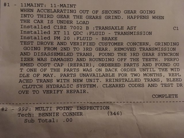

Good evening everyone. I’m currently stressed to the max over my 2017 Fist. Odometer currently reads 47 K miles. Upon purchase of this vehicle I received all prior service records and took it for a lengthy test drive. Everything checked out great. I did lots of thorough research on all years of North American Fists. To say the least I was a very confident buyer. Over the past couple months my car has seemed to acquire several different “issues”. I first threw a code for evap purge valve and bought a brand new evap harness from whoosh. So far it seemed to have remedied the issue. Following that I realized the incredible need for a rear torque mount replacement. Purchased whoosh rear torque mount (street spec) and installed it and found no actual improvement which I myself find it incredible to believe. I know whoosh makes amazing products and I’m not putting any blame on them or their parts. Keep in mind I baby my Fist like a sophisticated grandma that happens to know how to drive a 6 speed manual properly. Well, lastly and most stressful of all. There’s a pretty terrible grinding sound coming from the trans, sounds like a throw out bearing giving out. Where it gets to me bad is every time im shifting 1st-3rd driving it as smooth as humanly possible, the car not only feels like the engine wants to fall out but the grinding noise intensifies by a whole lot and simultaneously grinds louder when the engine is jarring back and forth. Previous owner had issues with trans at 11k miles. They found the 3rd gear syncro was damaged and could not get the parts to repair it for 2 months so Ford opted to put a brand new transmission in the car. So I currently clock 36k on this tranny. Please help.

First I will say I have the same rear motor mount it's a great product.
The person that previously had this car damage their transmission fairly soon, and they had it replaced sounds like they damaged it again. You just didn't realize it at the time because it wasn't showing symptoms yet.
Ford under-filled these transmissions from the factory they need about 2 liters of fluid not the 1.67 that comes in them. This normally damages the input shaft bearing not what you are describing sounds like a transmission rebuild is in your future. The powertrain warranty is 5 years and 60,000 miles. This does not cover the clutch assembly but it covers the transmission.

............ The person that previously had this car damage their transmission fairly soon, and they had it replaced sounds like they damaged it again. You just didn't realize it at the time because it wasn't showing symptoms yet. .. .......... ................ .... .. ................ ............. ......
Very logical. Especially given that synchronizer failures, especially repeated, are uncommon. This is even with Ford under-filling the transmissions by nearly 20% at the factory.
