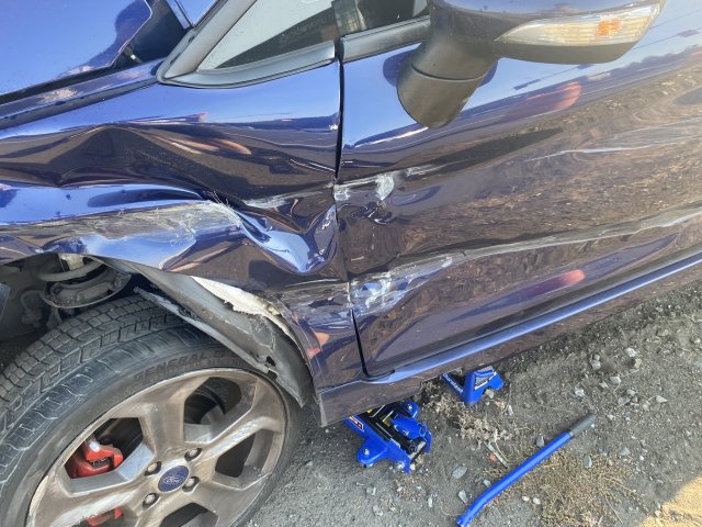

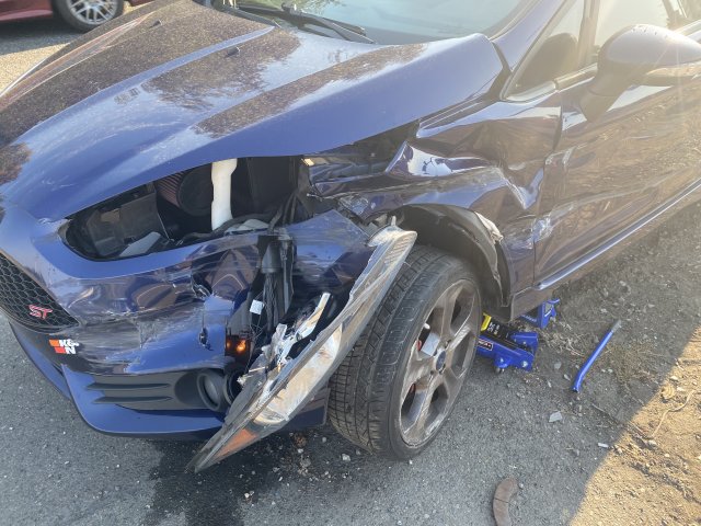

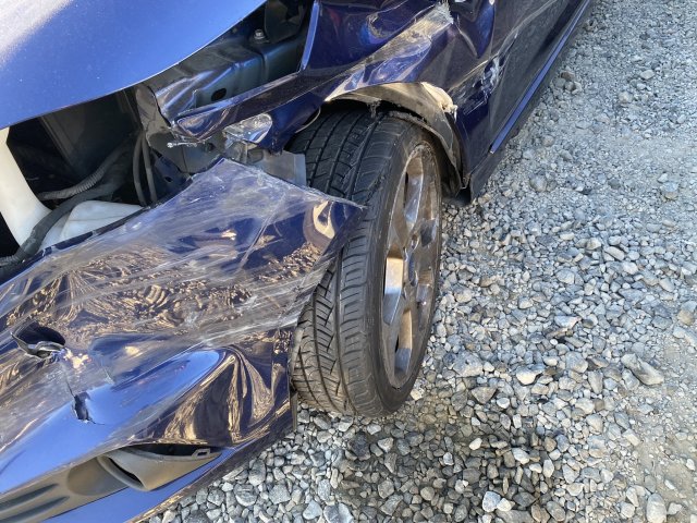

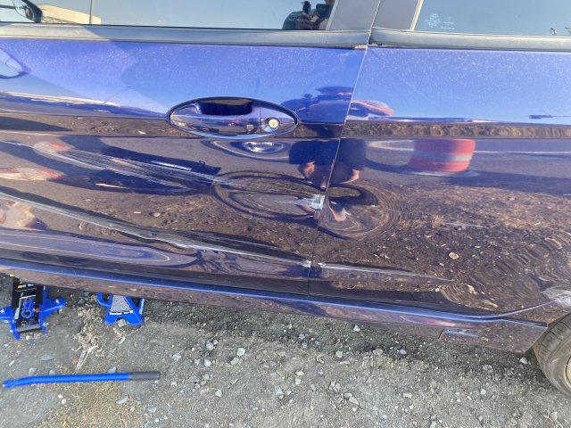

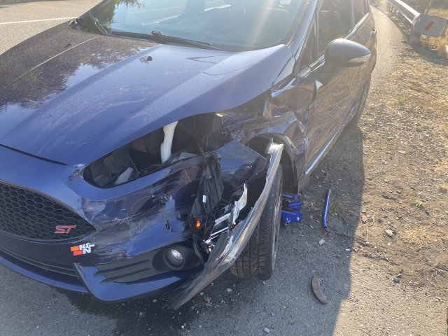

Hey all,
I got into an accident that ended up totaling out my vehicle. I have the option to buy it back and fix it myself/get it fixed as a salvaged car.
its going to be sold at an auction and I placed a cap for myself around $2k USD.
My question is whether or not its even worth trying to fix this damage.
I know the images/video can’t capture the extent of the internal damage and it might depend on if the frame is bent or not.
Thanks!

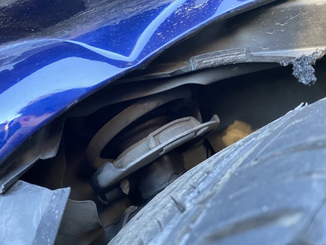

Is the frame rail bent? How does the suffrage assembly look? Is that bent too? If so, that is several hours on a rack to start with. Then you would need to deal with any drift from normal on camber, caster, etc to get it 'right'.
Really depends on how valuable that specific car is to you, vs getting another one that hasn't been damaged.

Now yours is a 2016 as it looks to be a Kona Blue so it’s going to come in at less value and easier to total. So the big question is what others have said and are to main things . Did your subframe get damaged? If not good you’re halfway there . Then did the frame rail get bent and what about your inner fender? Those three things will turn a relatively not crazy expensive repair into a possible completely not worth it.

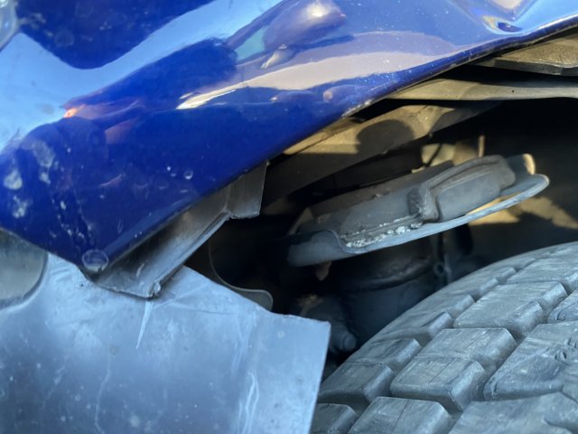

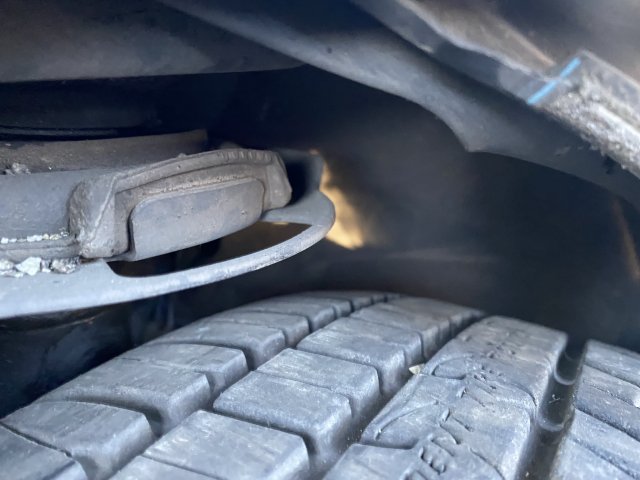

Does the car still drive? does it drive like normal or feel bent . From closer look at your pics you most likely have inner fender damage the question is does it down to the frame rail .Hits like yours get messy quick. It doe also look like you possibly have bent control arm.
Again it all comes down to answering these questions cost of repairs value of car and value of cash offer for a total.

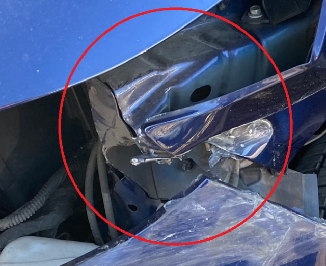

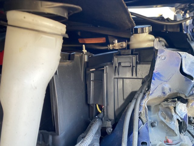

This part under the hood here, no bueno and would need replacing. I doubt it could be pulled:

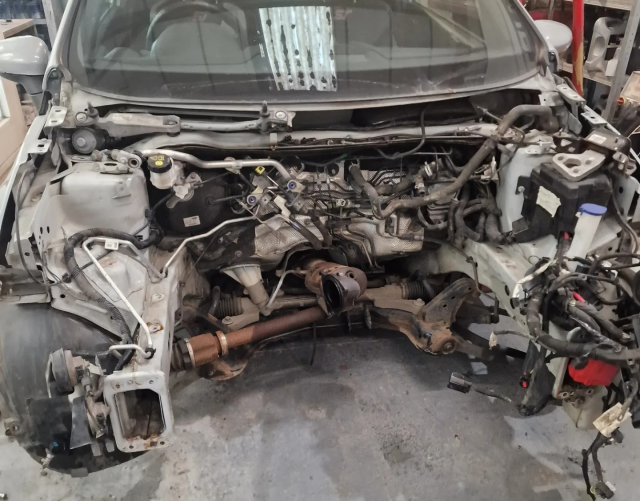

Found this picture, courtesy of STealthWerx. Here you can clearly see framerails, lower thick hollow posts. And the inner fender that would need replacing.
The framerail could have taken damage as it is made to crumble in a collision.
