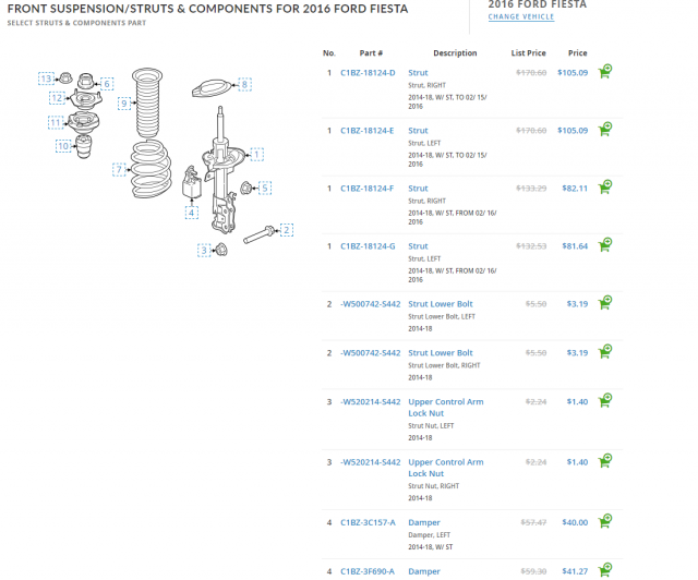

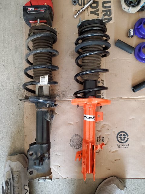

I am doing shocks and springs soon and want to replace everything in the front and assemble ahead so I can just swap the whole strut assembly. I have the part numbers for the strut mounts, bearings and dust boots, what else do I need, the strut top nut and...?
Anyone have an exploded view of the front struts with part numbers? If not I can go to the dealer thursday and get the run down.

Keep in mind, there is a different part number for the struts (item 1) between model years 14-15 and some 15-16+, make sure you get the correct one for your vehicle (VIN check on Tasca). A lot of the genuine motorcraft parts can be found on RockAuto for a good bit cheaper than Tasca as well (and they ship faster).
Spring isolator (item 8) was on back-order last I checked as well, took about a month and a half to get mine so shop around to try to find a place that has them "in stock" if you want to get them soon.

edit: I got to say going this route of pre-assembling struts w/ springs is certainly the way to go. I went this route and replacing the F&R springs and dampers took me under 2 hours

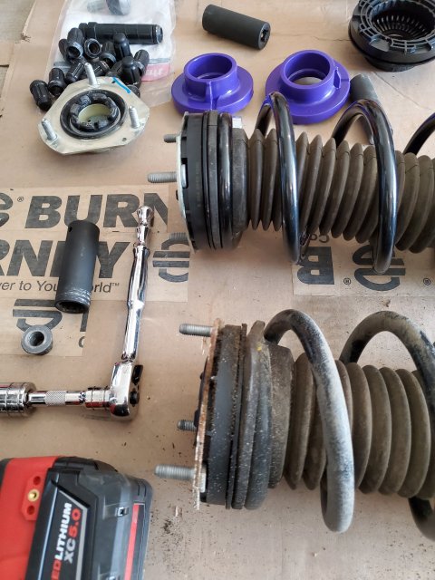

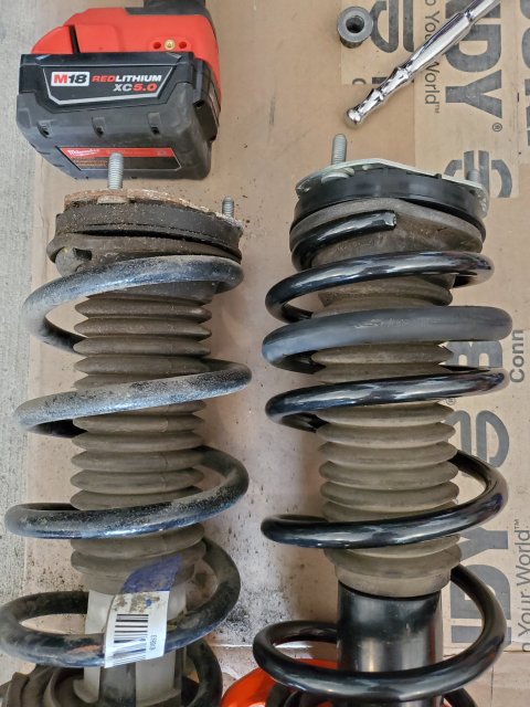

Working through the installation. Why is my top mount/bushing /bearing off kilter and lot level like the OEM stuff?
Th OEM is the passenger side as it came off the car, new stuff is the drivers side. Eibach says install with the writing on the springs facing right side up, but that seems orient them at an angle?

I put them in as they were, writing right side up. Still looks odd to me that the top turrets are at such an angle compared to stock. Everything seemed good when it was all back together.
I will go into detail more when I have time tomorrow or soon but the rock auto shock boots and bump stops are not at all correct, and my top sway bar end link nuts had red death loctite on them and could not be removed from the struts. New motorcraft end links don't come with nuts.
