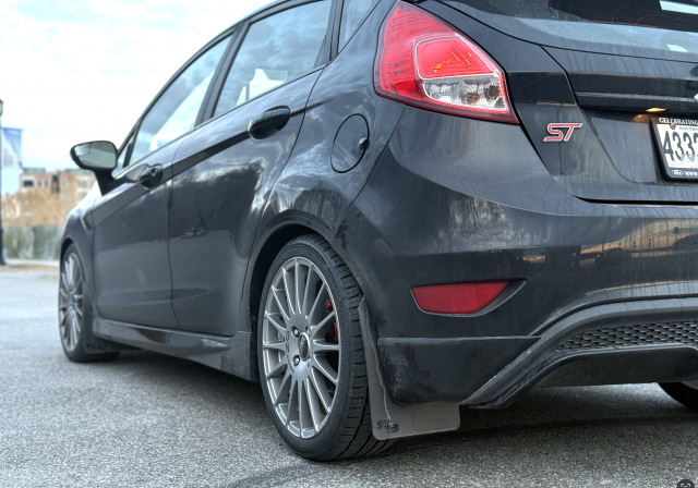

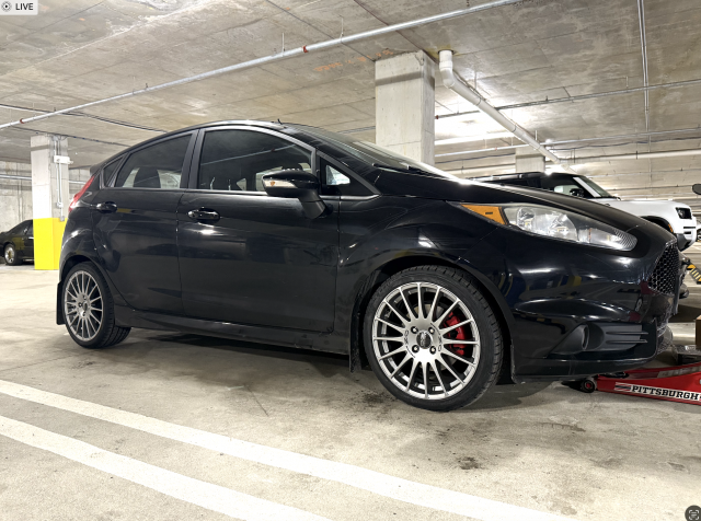

First two pictures are before (Stock Springs):

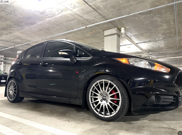

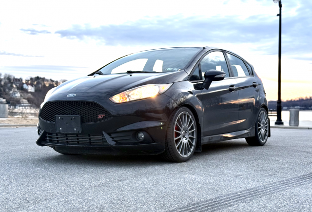

Next two pictures are after (Swift Springs on Stock Struts, Whoosh upper coil pads in rear):

Sounds like a good plan. I am going to get an alignment tomorrow. Just looking at the front wheels, I can see that there is a fraction of toe out, so I'm sure bringing it back to factory toe spec will resolve the torque steer/darty tendencies.
I also experimented further with the tire pressure. I raised the pressure back up to stock specs again and went for a drive. Much harsher. Then after lowering back down by 3 PSI per corner, perfectly compliant. It really makes a huge difference in these cars (at least on my tires).
I also had an opportunity to push the car a bit more, and am pleased to report that the higher speed cornering dynamics remain fantastic. The car rotates a bit more on lift, which I expected given that the swift springs increase the rear spring rate far more than the front spring rate.
Took a couple more pictures now that the springs have had more time to settle. Very happy with the way the car sits on the OZ wheels now. The drop, wheels, and mud flaps together achieve the subtle 'tarmac rally car' look I was going for.
