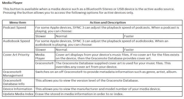

NUTSHELL: If you run into any problems with playing back media, try "Settings", then "Media Player", then select "Update Media Index".

https://www.fordservicecontent.com/...rket=USA&div=f&vCode=&vFilteringEnabled=False
I went to "Settings" then "Media Player" then selected "Update Media Index". No indication that anything was happening so I hit again. Still nothing. But before I could hit it a third time, music just started playing. I believe the act of simply switching media devices (plugging something different in) has the same impact. But this saved me the trouble of finding something else to plug in.
