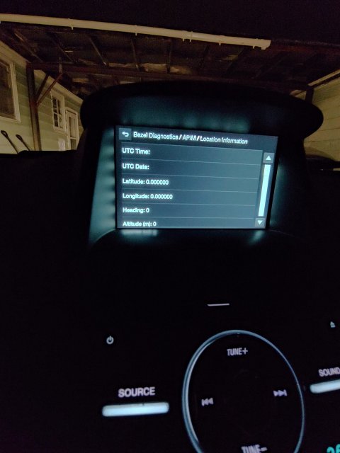

Well heres my nav problem. I habe no satellites in link, and my car is in the center of the earth according to the test settings. Kinda frustrating still. Its set up to auto download updates to the sunv system but something is wrong here.

My antenna for satellite radio/am/fm broke and i had to replace the base. But the gps antenna is in a different spot right? I didnt do anything with the head unit at all yet. Also fixed some parts clearance issues driving me batty and fpund mt check engine light source.

Where is the antenna for the gps system? Is it a part of the radio antenna assembly? It only had 2 connectors. Im trying to find answers so i can check things out (cant really be without my car at all) i keep getring different locations when i search it on google.

No. It failed after i replaced it with an oem antenna base for a car with sync 3 and a new antenna.
As far as i know the only things that was hooked to was satellite radio, and am/fm
